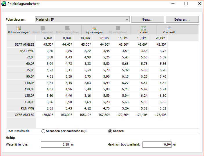

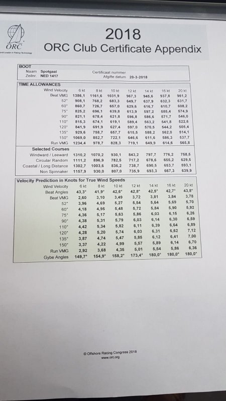

Hi Karin,
Do You mean something like this?
The first one is a part of ORC certificate (not 100% right)
The second one is from an old navigationprogram
