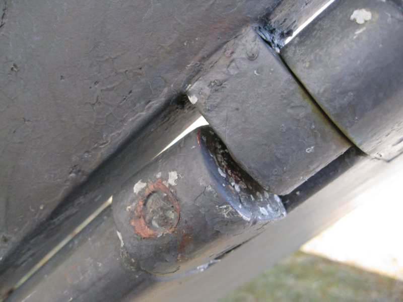

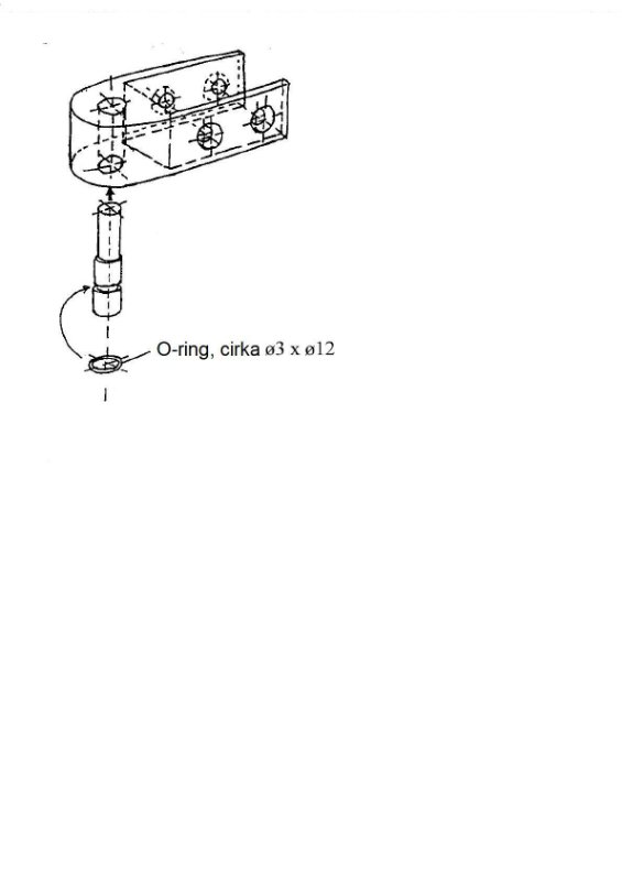

On the attachements you may see how the O-ring is mounted on the pintle and how the "rudder stop peace" is mounded to the rudder under the pintle. Those "rudder stop peaces" are normally fixed to the rudder by a scew and have to be removed before lifting the ruddder.

These O-rings are simple ones from rubber. Sealing rings of a 1/2 inch hose garden watering hose system will do.
